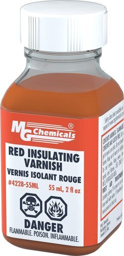

The problem there was the acetone started to breakdown the resins applied to the transformer plates at the factory, creating a gooey mess that was even harder to clean thoroughly.
I'd just fork out for the real deal, if the plates touch eddy currents can build up.

the noise returned after about a week. Upon close inspection, we could see the polish became brittle and started to flake off.
Sounds reasonable - it's being hammered by high frequency vibrations after all. And nail polish is notorious for flaking too. For anything to withstand those vibrations it would either need to be slightly flexible or very hard - like superglue. I would guess that insulating varnish sets similarly hard?
Not likely. Remember, typically transformer plates are stacked on top (or side by side) of each other at the factory. This is different from a coil where the windings are spaced some distance apart.
But regardless, as I noted above, squishing epoxy putty between the plate would prevent any unwanted contact.

One possible reason: soldering temperature tolerance: adding CA glue after a component is mounted is no problem, but adding it beforehand is likely not possible due to the heat of SMD component mounting temperatures with unleaded solder (which is required for ROHS compliance). At that point that glue would likely see temperatures way higher than it could tolerate, causing it to melt, deform, or even catch fire. And there would of course be some unpleasant fumes involved either way.
They would not use super-glue
True, but that varnish is still just rated up to 180°C, nowhere close to enough. And it dries in ~48h at room temperature (for a thin surface coating?) or 1h at 80°C, which is rather impractical. The datasheet doesn't say anything about curing for using it in voids/in between parts, which might be even longer. And no word on shrinkage. That's the struggle here: finding a potting compound for the inductors that's non-toxic (or close to it), doesn't shrink noticeably when cured, is sufficiently hard and strong, can take ~300°C, and sets quickly, ideally at room temperature. And of course has good insulating properties. That sounds pretty much like a miracle material - while adding superglue after the fact counteracts a lot of the problems with finding such a material. Or, of course, varnish like that, which would probably work just as well - I can't say as I have zero experience with it.

Electrolytic capacitors are good to 105°C but are fine for soldering; the 180°C is service temperature.
One could use epoxy; the boards are made of epoxy so there should be no temperature issue.
True, but service temperature for a capacitor is the temperature it can operate under for X thousand hours before failing, while the "operation" of a varnish is... well, covering something while not conducting electricity. I highly doubt there's any major difference between operating and installation temperature for that varnish, unlike most electronic components. That isn't to say it'll immediately break down or catch fire at 300°C obviously, but if it could handle that, it seems reasonable to expect that it would be rated for it IMO.
Definitely a good candidate, and frankly I expect the potting compound they already use to be some form of epoxy. The problem with epoxy is typically shrinkage though, which is difficult to avoid, and inevitably leaves gaps in a use case like this.

Bob Smith Industries BSI-205 Clear Slow-Cure Epoxy (4.5 oz. Combined): Amazon.com: Industrial & Scientific
This has an upper temperature rating of 180°C which happens to be the same as for the insulating varnish.
Or maybe a low viscosity epoxy
FDA-Bond 2 Food & Drug Administration Medical Grade Epoxy Adhesive, Low Viscosity RT Cure: Amazon.com: Industrial & Scientific
I'd just go with the varnish as no mixing is needed (I just made a repair with epoxy today, and, in this heat, things cured way too fast).
