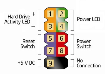

PC enthusiasts are most familiar with the following pin layout:
It is used for 3 decades on all motherboards, headers, interfaces and expansion cards.
You can't teach an old dog new tricks. It's safer just to say 1-8 rather than anything else. That's why I included photos to clear any confusion.
If it doesn't help, you can try flashing from EFI shell or with SPI flash programmer.
