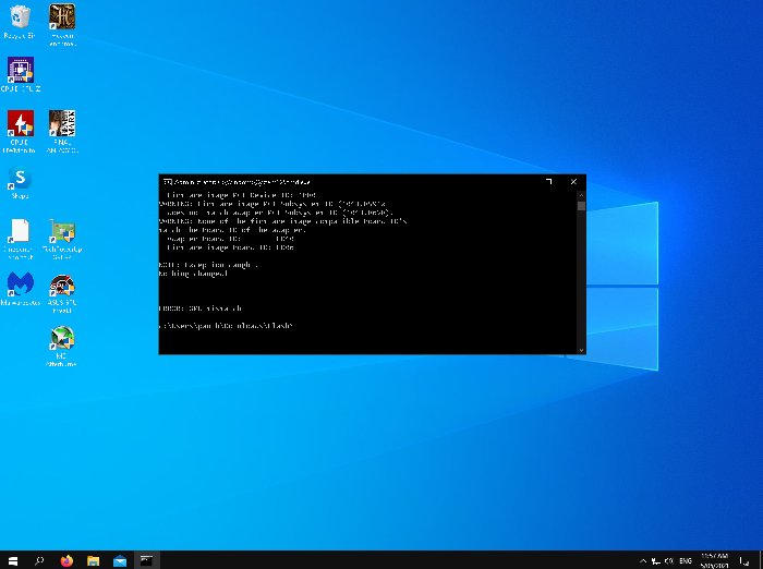

I'm trying to flash a card for the first time and have been scratching my head for hours as the"simple steps" shown in the O.P. aren't working for me and aren't explained clearly enough for a newby.
I can navigate to the folder with nvflash and the rom in it, but when I get to: "Type: "nvflash64_patched_5.590.0 -a" to see which adapter id is the bricked card"
It keeps chucking up an error message, wtf?
Edit:
I managed to get this far where it shows an ID mismatch and refuses to continue. :confused:
Could someone tell me how to get around the ID mismatch and force flash it?
Edit:
Text in the screenshot isn't readable. Add -6 to the command line to force flash.

Try -4 -5 -6 and make sure the device ID of the ROM and GPU are the same. If it's old card, try older version of nvflash. If the device ID was altered somehow (usually physical damage), you'll need CH341A to flash back. Subsystem/vendor/board ID can be force flashed, but not GPU device ID.
