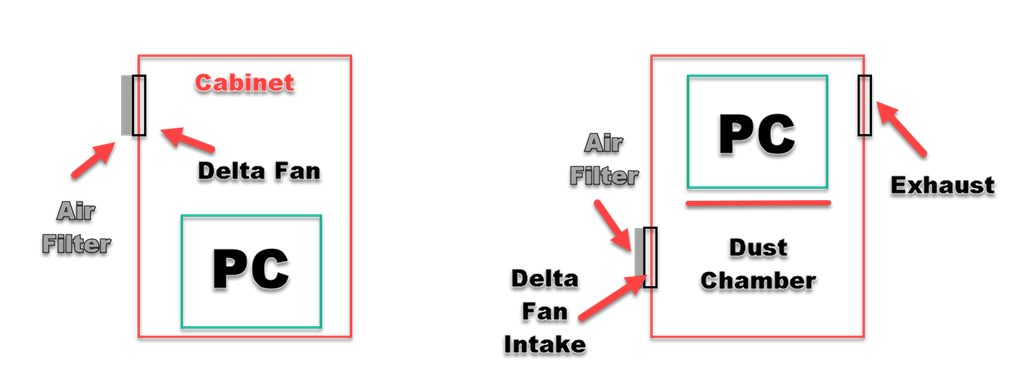

Another thing you can do is put your PC into a bigger box however this is probably not as practical for home use.
In the diagram below on the left my friends car shop PC get very little to no dust on the inside of the PC compared to the outside. Of course a car shop is a very dusty environment with a lot of heavy particles.
A better layout might be the diagram on the right.
Automotive air filters seem to work really well I was very surprised by the amount of dust they capture.
His Dell in the box never overheated even in the North East summer time. Sure it did get warm though.
I see, that’s a good idea and it certainly makes sense. I’m not sure if I could make that work, but I can certainly try. Itd definitely work in my room since it works in a car shop. I will try out automotive air filters for sure then. It’s good to hear that his Dell never overheated even during summer.
