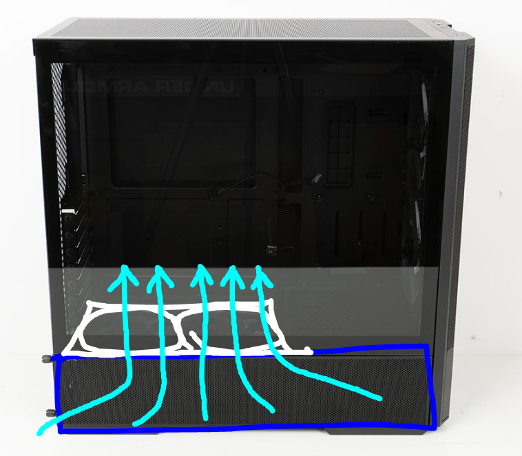

What would the point of dual rear exhaust be? There's nothing generating heat down there in the PSU chamber that needs airflow, and forcing exhaust from that area with a fan just reduces airflow from the main chamber where all the hot stuff needing the airflow is.
What's the point? Exchanging air. Taking heat out works better than forcing air in stirring around hot air.

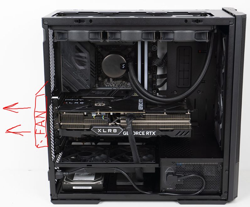

It'd go under the GPU somewhere. Like the 216 but without needing a riser. They could've done it in the O11.
I have no idea where you think there's room for that. The only place that could possibly accommodate a second fan is the PSU basement, and that's a pointless place to put an exhaust fan as previously mentioned. Not only is there nothing to cool down there, but it would also actively hinder the two intake fans in the basement.
There's only room for a fan beside the motherboard's IO plate, because the expansion slots occupy most of the width of the case. At best you'd be able to squeeze some nasty, pointless little 40mm fans between expansion slots and side panel - and they'd likely be worse than the airflow you get with the open mesh right now and four intake fans providing plenty of positive pressure.
If you really want exhaust, just flip the basement fans. It's a terrible idea that will 100% hurt the cooling to the main chamber but if you absolutely insist on doing something based on belief alone, then nobody is going to come to your house and stop you from reversing those fans.
The hottest things you could install down there would be a couple of hella noisy 15K SCSI mechanical drives, and even then we're only talking around 30W which will be serviced fine by the passive airflow out the back via positive case pressure.

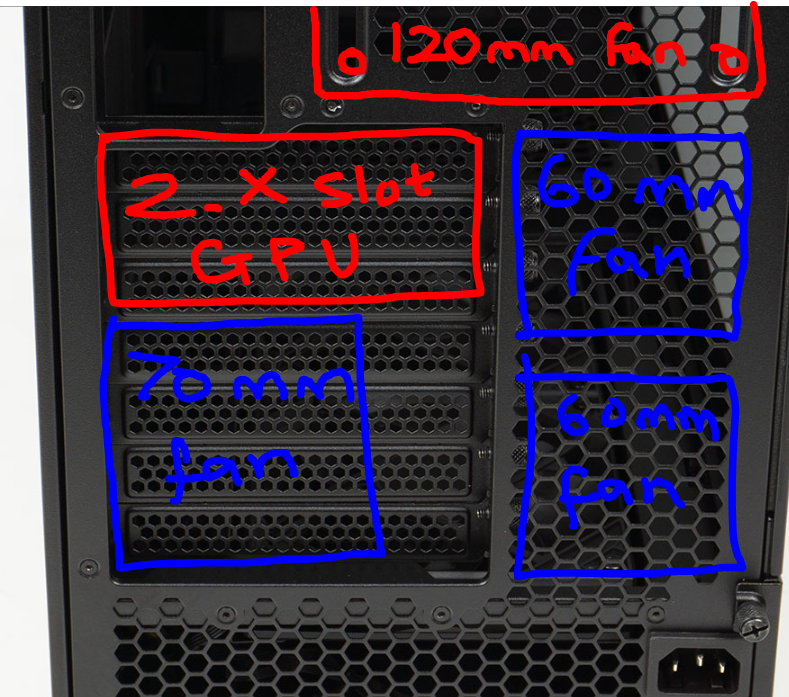

Yknow how some cases have a 140/120mm above the gpu in the rear and some have a load of unused pcie brackets under the GPU since SLI is gone now. There's no room for another fan anywhere you don't think? Have a bracket that replaces pcie brackets with a fan bracket. It's not hard to find the room if you make things modular, similar to the LL 216 but without a riser.
Positive pressure isn't really that big of deal either. What's important is exchanging the air in the case as efficient as possible. Top exhaust isn't efficient if the intake is the front.
So your 120mm fan above the GPU exists, I don't know why you're complaining about that because the mounts are there exactly as always in almost every ATX tower case ever
Uh, this is a compact case. There's actually no room for even a 92mm fan under the GPU and that's assuming you only use a strict dual-slot GPU. Most dual-slot GPUs these days actually encroach into the third expansion slot, so to fit a fan under that it would need to be 70mm or smaller. As for the sides, a couple of 60mm fans would work, but there really aren't any good mainstream 60mm or 70mm fans on the market. Hell, getting 80mm variants that aren't shit now is difficult.
(excuse the crap annotation, I'm on a phone on a train on a lumpy bit of rail)
Maybe you're missing the point if you want fans there. Your complaint about top exhausts wasting the airflow from the front intake fans is the exact same problem you'd get with exhaust fans, because all of the basement (blue rectangle) that you don't like is air intake for the two basement fans.
Rear exhaust fans under the GPU would just spit out this fresh intake air before it had a chance to go through the GPU. In case it's not obvious, adding exhaust fans to this case actually hurts cooling with no upsides whatsoever, which is why it's a dumb idea. In other cases with completely sealed basements, it's not a terrible idea, but only as a crutch to aid the dead spot a completely sealed basement causes in the lower rear of those kind of cases.

Is that rear fan intake? If so then it is fighting your front fans and serves no purpose. Is that rear fan exhaust? then it is taking air away from the GPU.
If you flip the front fans to be exhaust fans, and the rear CPU fan to be intake, then the rear mesh will serve as an intake without any fans added to it, and that would be sufficient.
Anything is possible. You're just refusing to believe it because you don't think you want it. I'm not necessarily saying THIS EXACT CASE NEEDS ANOTHER REAR FAN. Forget about the basement fans. I'm saying, there's room and it needs to be made. Make it modular. Make cases with dual rear fans without a gpu riser. It's 100% possible.
Not refusing to believe - I'm speaking from experience as a qualified engineer with a year of study in fluid dynamics and a reasonable understanding of airflow through a volume both as a student and when I was employed as an engineer prior to my IT career.
Exhaust fans below the GPU in this particular case design is unquestionably worse, it will remove airflow from where it needs to be, it does add expense unnecessarily, and it serves no purpose when the back of the case is so well ventilated it's close enough to a fully-open design in terms of pressure and flow restriction.
If you want a wider case to fit fans where there's no room to do so here, then go and buy a wider case. There are plenty of them on the market (hell, there's an almost unbearable flood of the damn things). The more expensive wide-body cases even have modular PCIe slot covers for various configurations around GPU mounting and I'm sure you can hack a fan into one of those if you really wanted to.
Please stop complaining that this isn't a wide-bodied, modular fishtank case when it's budget compact case. You're not just barking up the wrong tree, you're barking in the wrong forest in the wrong country too!

If I could put it anywhere I wanted I'd put it behind the rear IO grill of the GPU. Directly behind the gpu. Sucking air through the rear gpu grill.
I really don't think it'll remove airflow by bringing the intake air to flow over gpu fans but how would you know if you never actually tried it? Just trust me bro I just sit here and think about it not working so it won't?
You mean here? Where do your display cables go, other than through the fan blades? Your suggestions are getting weirder with each post!
