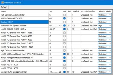

So to see what happened with IRQ i need to uninstall drivers fully and install them without switching off PC. What i should see exactly? I will attach screens.

Also you didnt explain what i should see with MSI Mod Utility V3 ?

Here is my IRQ for X-Fi - there is no any acceleration - all default.
