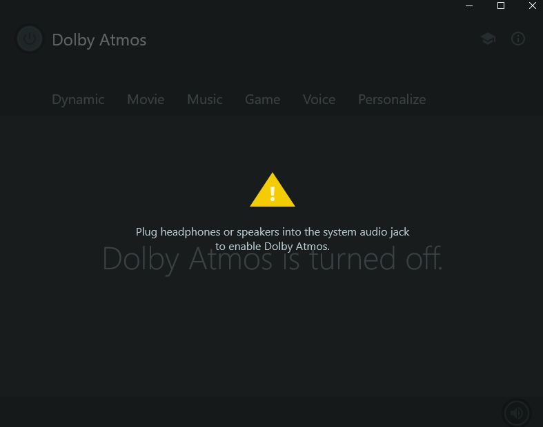

installed the DCH-UAD VERSION without problems and installed the Realtek Audio Control UWP app from store, wen try to open Audio Control app, shows for 1 second and closes itself, what can it do?
Dolby Atmos wont work, but in legacy version the control panel and dolby atmos works perfectly
Type Windows + R on your keyboard, type "services.msc", search for "Realtek Audio Universal Service" and check if it is running. If it is not running, right-click it and click Start Service.
Follow the steps of the "(MANDATORY) FOLLOW THESE STEPS (ONLY IN DCH-UAD VERSION)" spoiler on the first page of this thread.
IDSG89
Jun 23, 2020
8 (0.00/day)
Followed the steps of the "(MANDATORY) FOLLOW THESE STEPS (ONLY IN DCH-UAD VERSION)" and dolby atmos its working thanks but the Realtek Audio Universal Service is running and the audio control still closes itself on startup =( , what can i do?

DO i need to install the APO driver to use viper4win with this package? I'm having a difficult time understanding how to get all this working.
Jun 20, 2020
3 (0.00/day)
Try using APO Driver from PureSoft Blog. Google Puresoft APO driver. And when installed, Just tick the Creative Sound Blaster UWP option in Driver Maintenance(blue Icon) which comes with APO Driver. It should start working.
that was not a bad idea but I had to activate all of the APO's for Realtek, Dolby, DTS and Sonic Studio 3
and I had to insert everything in the FX Configurator individually + load the registry files
luckily I have used the APO driver a lot.
But that didn't help :/
Update:
I reinstalled windows 10 again. (Windows 10 Pro for Workstations Version 2004 / 20H1)
- Windows updates
- Latest Chipset
- AiO Runtimes from: http://puresoftapps.blogspot.com
then I installed the audio driver mod and followed the steps of the (MANDATORY) FOLLOW THESE STEPS (ONLY IN DCH-UAD VERSION) from the first page, otherwise no device was recognized.
so far the Sound Blaster is running, hope it stays stable.
