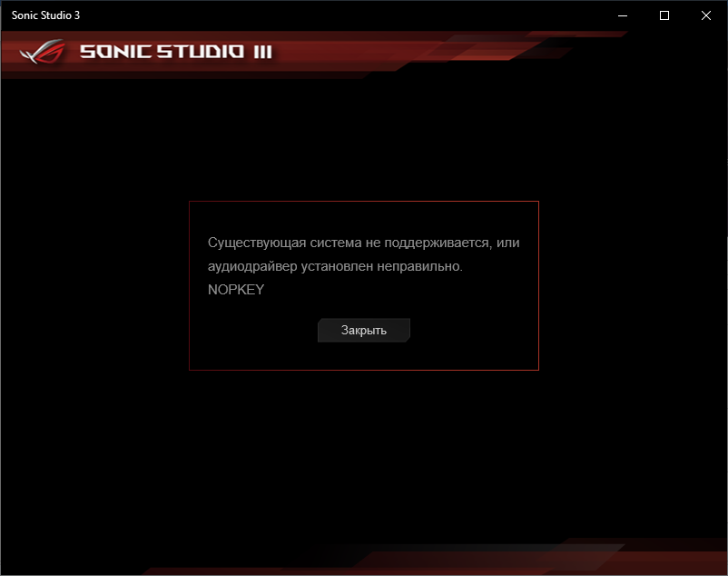

Hiya Alan, I uninstalled AAF (twice) even used DDU but I cant install new version. I get the same error.
Luckily I have a backup but I tried to install Sonic Studio and I guess my old codec is not supported.

My problem, audio effects of other applications such as Sound Blaster, Sonic Studio 3, and Dolby Atmos do not work, but Realtek ones do. Already tried the "RunningonWindows8point1" fix.

Also sonic studio 3 says "the current system is not supported or the audio driver has not been properly installed TIMEOUT"
