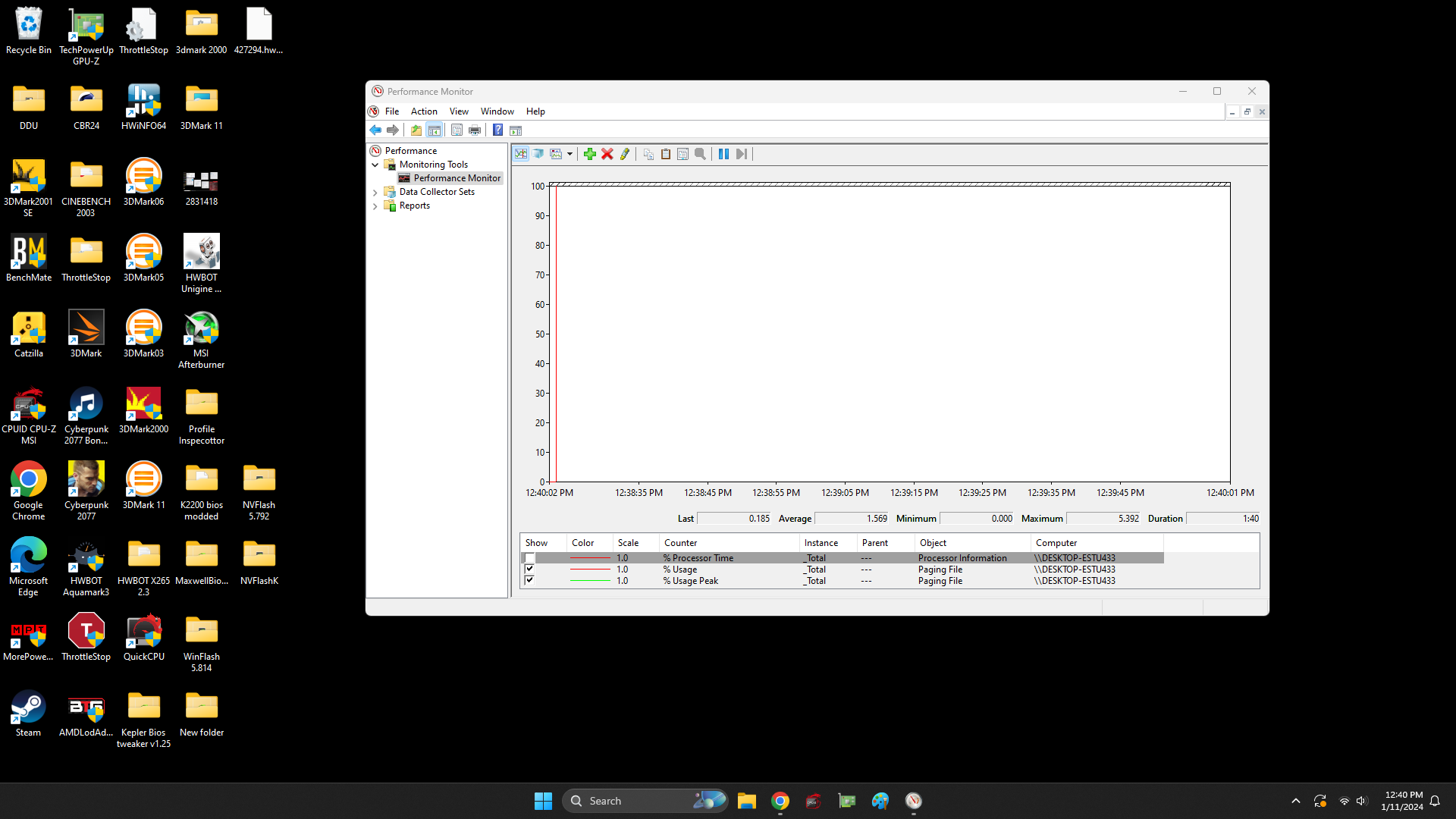

I have not seen in the last 20+ years a case where disabling the page file "improved" performance. Not one.
There are several, persistent misconceptions out there that some just refuse to accept. And that is too bad. Maybe 25 - 30 years ago, there was some basis to those misconceptions, but not today. They need to be let go.
One of those misconceptions (not mentioned above already) is based totally on bad logic. And that is the "excuse" some use to justify disabling the page file. It goes something like this. "I disabled the page file and it didn't break Windows (or I didn't see any difference) so I left it disabled." That is totally illogical.
What is logical is, "I didn't see any difference so I enabled it again." Now that makes sense.
It should also be noted that Windows does not stuff "high priority" data into the page file and keep low priority in RAM. Window is smarter than that. So even if you have 128GB of RAM, Windows may still swap "low" priority data to the page file. And guess what? That does not adversely impact performance.

and ensuring that Windows used physical memory whenever possible.
But that's one of those misconception. Ensuring Windows uses RAM whenever possible does not ensure maximum performance all the time. What that does is force Windows to close open files and save them back to disk where they will then have to re-open the files (and create a temp file) to fetch that data again. When it can simply swap that data ("data" not file) to the page file, then when needed again it can simply fetch the data without going through the extra steps of finding the file (and all its segments), opening the file and fetching the applicable data.
@DR4G00N is right,
there's no reason to ever disable it. If it doesn't need it then it won't use it, simple as that.

You can easily view your Page File usage in Performance monitor. Under monitoring tools, select performance monitor again. in the box, right click and add counters. Select page file.
Now you can see your PageFile usage. Here's what it looks like, I unchecked processor time as you'll see here.
NOTE: I am not saying to turn off or turn on or extend page file. This is informational only.

But that only tells you what is happening during that computing session for those tasks you recently performed. This afternoon or tomorrow, or next week it all may change. This is the primary reason it is NOT a "set and forget" setting and a primary reason the default setting is dynamic.
I'm not advocating anything. Just a way for those to view the page file usage. It could be really useful for those that use a lot of applications that are memory intensive to get an idea of how much physical memory can or will be pushed to the page file.
But I'm pretty sure that's a live view. You may know better than myself if that changes over time or not. This operating system is but a couple few weeks old. It gets re-installed at least every 6 months even though W11 is awesome for backwards compatibility, I keep it fresh. Because the main purpose of my PC is solely competitive benchmarking. (but that's me, not everyone else)

It is live but shows peaks too - at least for that session.
