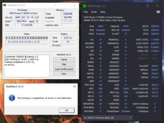

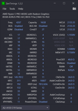

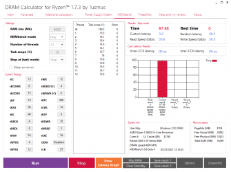

I posted in another thread as well
Struggled with 4x8 at CL15, so moved to CL16....altering a few subtimigs got me just as quick as CL15, which is rather interesting. Pics below for comparison

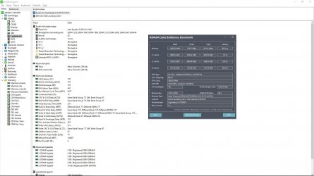

Can't get my hands on Ryzen 5000 series
Reduce to 3800\1900IF or 3733\1866IF and reduce latency by 10ns. Also try disabling GDM and using dram calc :)

Xeon Gold 6138 Es from china. Mixed ram oc to 2666

Trying to chase that 60GB/s copy in a daily stable profile for iGPU gaming:

Thats some crazy Infinity speeds. I wonder how much AMD can push next gen with DDR5 and if we will see some asyncronius magic to utilise the potential of ddr5
tabascosauz
Jun 24, 2015
8,219 (2.33/day)
Western Canada
System Name ab┃ob
Processor 7800X3D┃5800X3D
Storage 8TB of SSDs┃1TB SN550
Case Caselabs S3┃Lazer3D HT5
The other 4650G guy on I think the last page got much better B-die and a better binned CPU. No idea if that 4533 is daily stable or how much vdimm but it sure is impressive, esp the 2272MHz IF, I can do about 2200
That said, mine isn't in an ATX Hero, it's wrapped up in a 5.3L acrylic case about as tall as a can of pringles sooo :D there's only so far VDIMM I can go on 2 x 80mm Noctuas
The APUs are already halfway there, if they can further minimize the copy and latency penalty a bit then 2:1 at extremely high speeds could very well be viable, if we have the RAM to do it

I did some testing with a AMD Ryzen 5 4650G Pro before it was installed in my TrueNAS server. I ran Prime95 (Large FFT's) for 7 hours on these settings so it seemed stable. In the server it is only running at pedestrian 3200MHz with unbuffered ECC modules. The memory modules used for the test are Gskill 2x16GB 3200MHz CL14 B-Die, dual rank.
