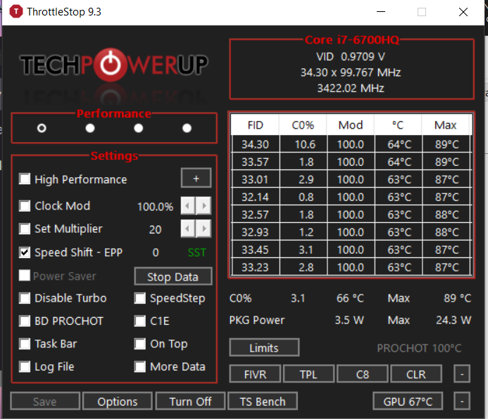

Hello,i also am experiencing throttle or red bars on PL1 and PL2 and cant have a stable fps on fortnite meanwhile i can push and maintain 120 for 4 minutes or so and then cpu starts to go to drain 0.40ghz.What can i change to maintain a decent fps? Thanks

@ChromeG - What laptop model do you have? Turn on the Log File option in ThrottleStop, play a game for at least 15 minutes and then attach a log file to your next post. It will be in your ThrottleStop / Logs folder.
Your screenshots show that you have disabled half of your CPU. Did you do this on purpose? In the BIOS make sure hyper threading is enabled. Run msconfig, go to the Boot tab, press Advanced options... and make sure the Number of processors box is not checked. If your CPU gets too hot when it is fully enabled, redo the thermal paste and try to fix the cooling problem.
You can also try using the Lock option in the Turbo Boost Power Limits section. If your CPU is getting locked to 0.40 GHz, I am going to take a wild guess that you have a Dell laptop. Some of their laptops use the EC to set the turbo power limit internally to 0. This forces full on CPU throttling down to the minimum speed.
Check the TDP Level option and set that to 0. A setting of 1 forces a low power U CPU into low TDP mode.

Lenovo Thinkpad T590
Your log file does not show your CPU running at 0.4 GHz. When it is loaded, it starts to power limit throttle at about 22W and runs at 3.2 GHz to 3.4 GHz. That is completely normal for a CPU that has a 15W TDP rating. Better than expected.
Check the FIVR - Disable and Lock Turbo Power Limits box. On any Lenovo laptop, I would also check the Options - Lock PROCHOT Offset box. Some Lenovo software will change the PROCHOT Offset value while you are using your computer. It is best to lock PROCHOT Offset to a fixed value.
After you do this, run another log file while gaming. A 12 thread CPU burner test is overkill. It can overwhelm a laptop with a 15W CPU.

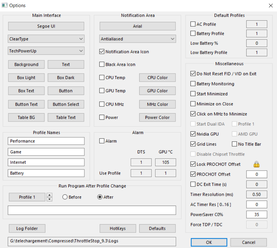

@ChromeG - Did you check the Lock PROCHOT Offset option yet? This is a must on Lenovo laptops.

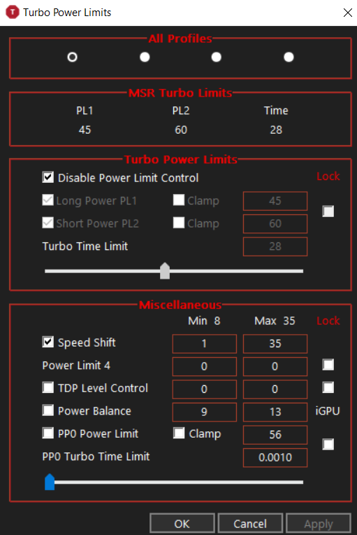

Hi, my laptop is Acer Nitro 5 i7-8750h with a 1050ti. I keep getting throttled because of the PL2 then PL1 but temps are normal since i got liquid metal already. Could you have a look?
Also how should i set my CPU cache offset voltage?
I saw one of the previous thread you suggest changing PP0 current limit but I cant seem to find that option in this newer version (9.3), should i tweak it and how?
Thanks in advance!
Power limit throttling and thermal throttling are two different things. Good temperatures do not matter if your computer is power limit throttling.
The 8750H has a 45W TDP rating.
Acer has decided to enforce this 45W limit. Many manufacturers allow you to go beyond 45W. Acer does not allow this. Your are stuck at 45W and there is nothing you can do. The settings in ThrottleStop are ignored when a manufacturer sets a hard limit of 45W. Acer has set this power limit internally and ThrottleStop cannot access it.
POWER STATUS CHANGE
If you are wondering why your log file has all these notices, it is probably because your computer has been set to only charge your laptop battery to 70% of its maximum charge. I like keeping my laptop battery fully charged so it is ready to go when needed. Manufacturers came up with this 70% stuff to reduce any warranty claims. I would rather buy a new battery than have some software constantly monitoring my battery and adjusting it every 5 seconds. Find out how to turn this feature off if you want to get rid of those messages.
TS 9.2 used to call Power Limit 4 the PP0 Power Limit. This was the wrong name for this limit.
TS 9.3 shows the correct name, Power Limit 4. Your screenshot shows that you have this set to 200. That is great. Nothing to worry about.
It is the internal PL1 turbo power limit that is causing the throttling.

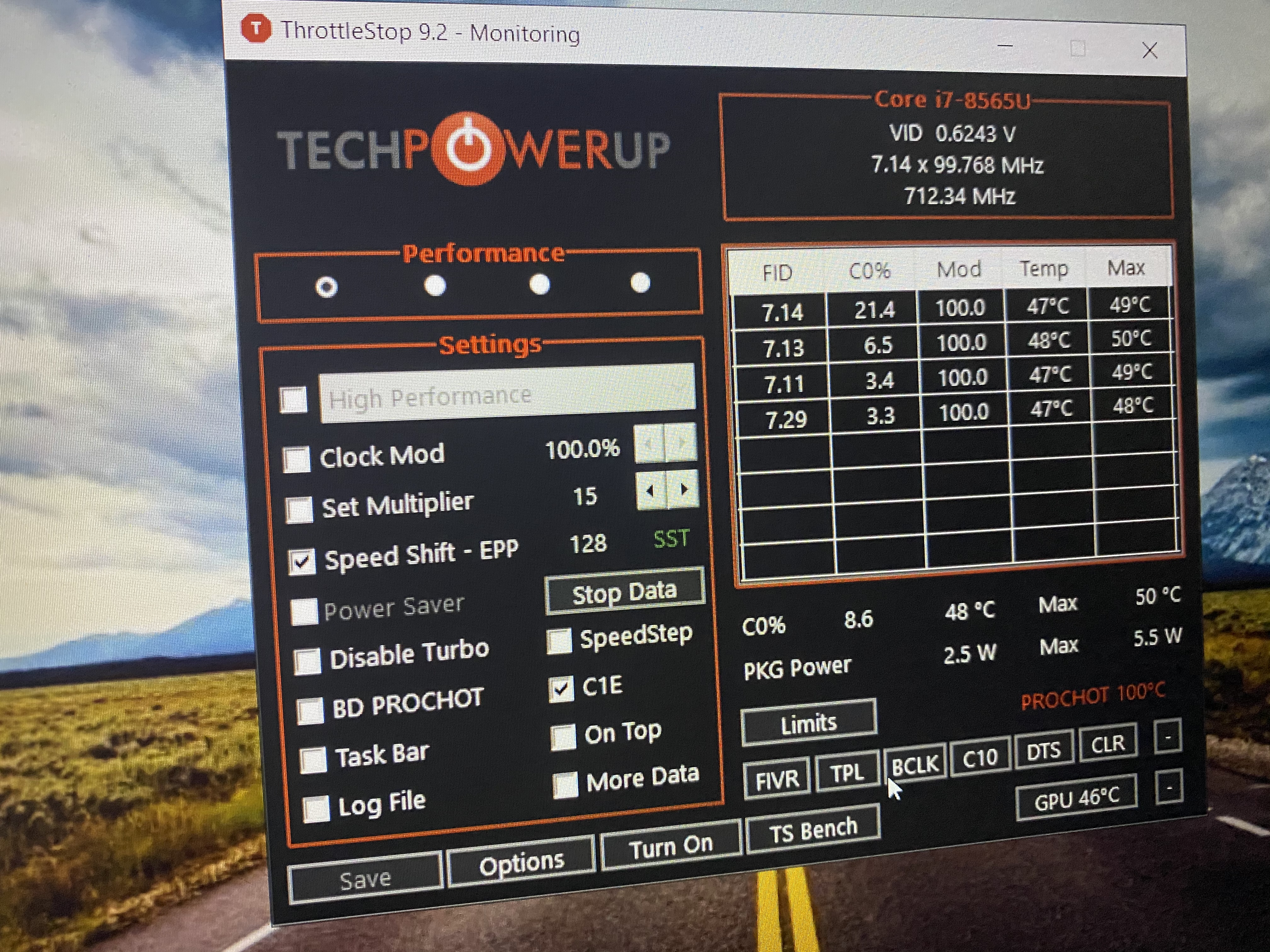

a higher Cinebench score
With good cooling and unlocked power limits, the 8750H can score over 3000 points in Cinebench R20. Keep that in mind next time you go laptop shopping. There is a wide variation in performance even when the CPUs are identical. It all depends on how a manufacturer sets up their laptops and what they lock down.
I couldn't check the EPP that cpu is using.
With my magic red marker, let me help you find the Speed Shift EPP value in the monitoring table.
Maybe you have been playing too many video games. :p
