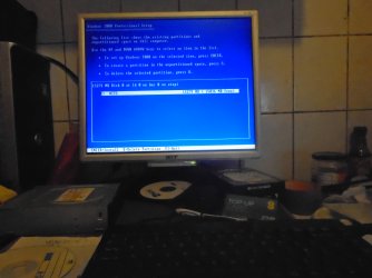

There is no problem with the CF card i am using as a hard drive, it is a industral one.Before that message comes up it says something about the bios?.Ir is only on there a few seconds.What should it be in the Bios?
That looks like the BIOS is not seeing your CF card. Make sure your card settings are correct and make sure the drive parameters are set properly in the BIOS. Additionally, you might need to create your OS partition with FDisk before begining the Windows install.

Thanks once again for your valued information Lex :) I was under the impression you could use a CF card on any windows os.o_O plus the fact it is a industral one that is not seen as a removable drive ,I will give that a try Lex:)

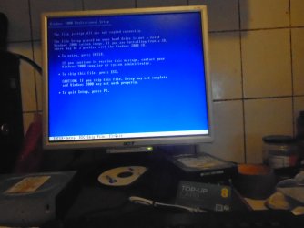

I am not sure what to do FDISK that is o_OI just wish things worked out of the box.:( I am trying to get 2000 on there.Do i need to create a partition or just press enter?Io_O I will try partition as i usually just press enter.Nothing worked when i tried to partition it. :( It came up with 785 again.:(4

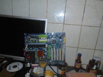

NTLDR is missing the two green slots on the edge of the board don,t work :(That should not stop the problems i am having.I will try another board.They look all right to me. :) I am now trying the Pentium 4.2 6 board the one i got with that really heavy big case which i want to give away.Shame no one lives in London on this forum. :(This screen is a lot better than the other one i was using. :)

How do i do this i am trying to put a OS on a CF card.Iam on PTDD Super Fdisk 1.0
and got to this point
*Warning size of Harddiski 1is O M
Please setup bios and run HDD IDE AUTO DETECTION * How do i do that? o_OCan that be done on Fdisk or is that done on the boards Bios? o_O

you need to create a partition and mark it as bootable then you need to format it and then install the OS on it

Do i do it with mini tool partion and what size should it be on a 30gb and 16gb ? o_OI have managed to get a os on one of the Cf cards . It goes all the way to the end then says it will restart.Then starts the whole process of putting the os on the drive again :( How and why does it do that, and how can i stop it doing that?o_O
When i try to booting the CF card after taking out the disc it says *invalid Partion table*

It goes to this and just stops :( I partitioned it with the MINI TOOL
Primary fat32 8mb partition on a 32gb cf card.It says something about the BIOS not set ?
Sorry @Greenslade, the only experience I have with CF is with a really old digital camera. I never tried to adapt it as an HDD.

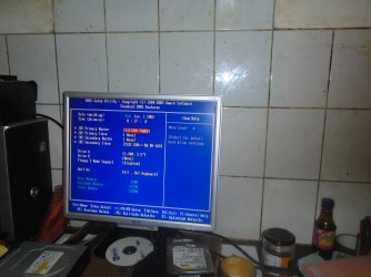

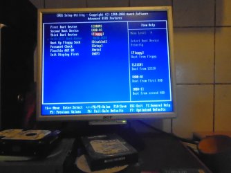

I don,t blame you after all the trouble i am having.:( I was told it was straight forward as Phil says in his videos.:(What do i do in the bios is set at Auto detect.Bios below.I am trying to get a Windows 2000 on a IDE Drive.It is taking its time at formating.Heres hoping.
Can someone give me a link to Gparted i got the live one i just want the basic version.It sounds like a lot of work. o_O Windowa 2000 put on a IDE drive it tooh an age to do it.If i can get it on a IDE i should be able to get it on a cf card. o_O
