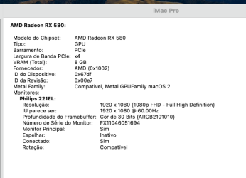

Oh my God...
It really works....
All ports (DP - HDMI - DVI) 100% working on Windows/MacOS/Linux...
Congratulations, this will definitely help a lot of people who use MacOS with these more affordable cards.....

blackCH
Apr 16, 2023
25 (0.04/day)
Oh my God...
It really works....
Great. Glad you got it working.
I see you patch yours to show as a 580 instead of the 570.
Cheers

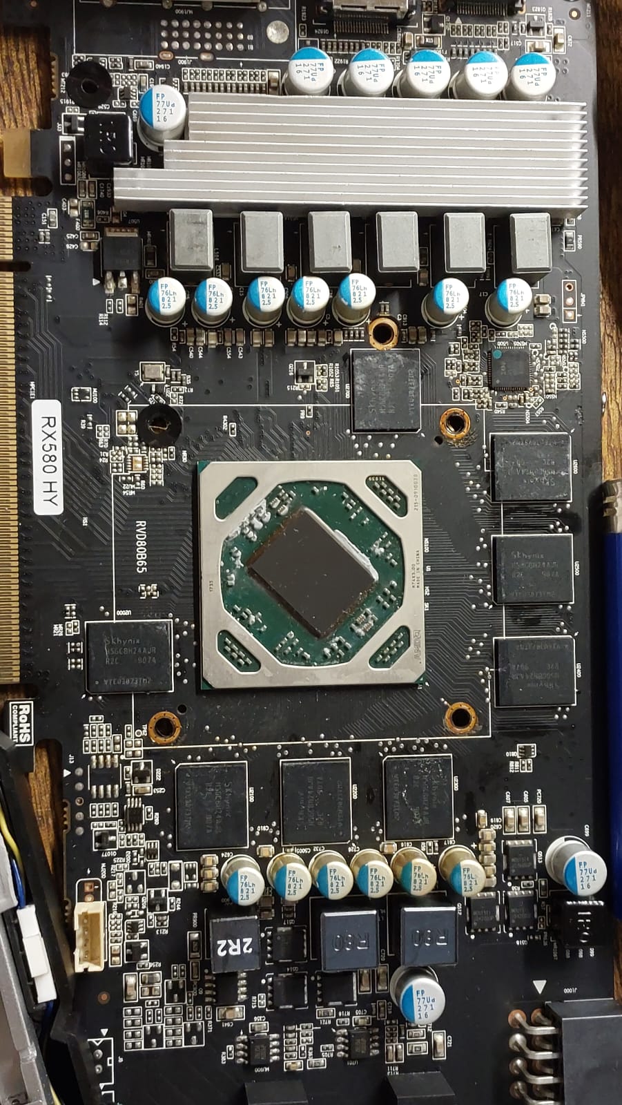

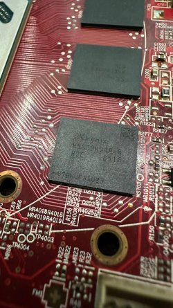

Yes...
I correct the id because my board has an RX580 GPU....
"215-0910038"

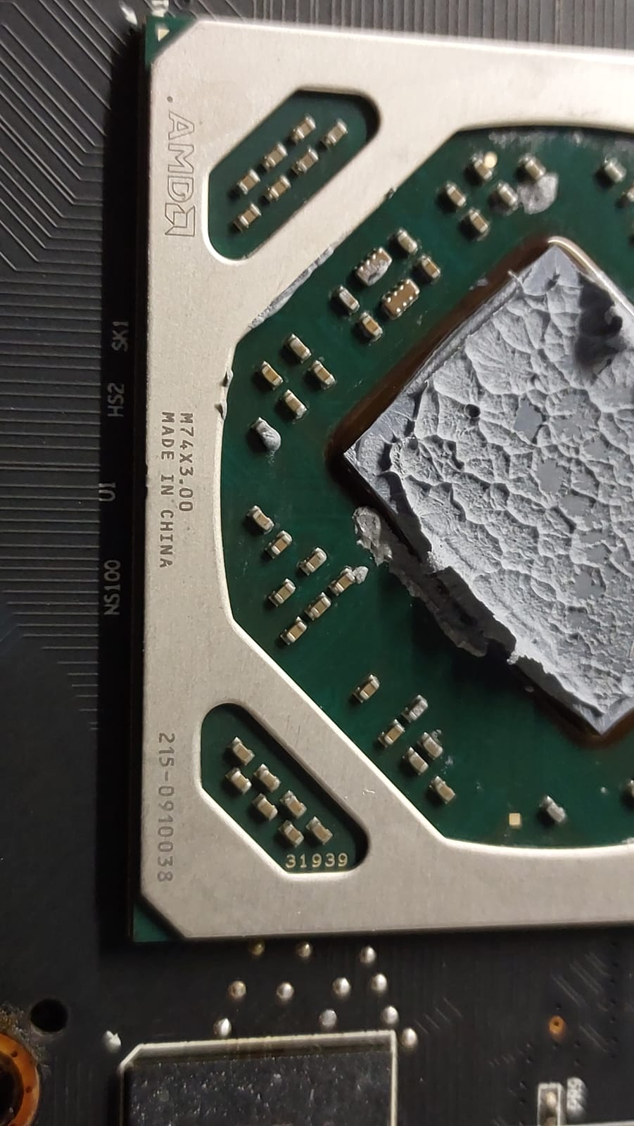

Hector_BR
Mar 17, 2023
11 (0.02/day)
Nice! That chip should have 2304 stream processors instead of 2048
I believe so...
But I haven't found any "true" RX580 bios that work the video outputs correctly...
So let's go with 2048SP anyway.... :)

blackCH
Apr 16, 2023
25 (0.04/day)
Hello everyone. I have followed the steps that my colleague blackCH has put but when I flash the bios it recognizes it and it works perfectly on mac but in Windows 10 it gives me an error I get the screen with low resolution and it won't let me change it and in the device manager I get that there is a problem in the Radeon RX570. What could be the problem.
What parameters do I have to change so that it appears to me that it is an RX580 since I have also changed it and it continues to appear that it is a Radeon RX570.
That might be a windows driver problem. I havent use Windows since Win 7 days so I cannot help much with that.
Whats the ASIC model on your card?

blackCH
Apr 16, 2023
25 (0.04/day)
What do you mean by ASCI model?
My graphic is an ENVINDA RX580 2048SP 8gb
You need to remove the cooler and see what ASIC chip is on your card (because it can vary from card to card, regardless of the model shown by the BIOS).
There is a part/model number etched on the frame of the chip (lower-right corner):
