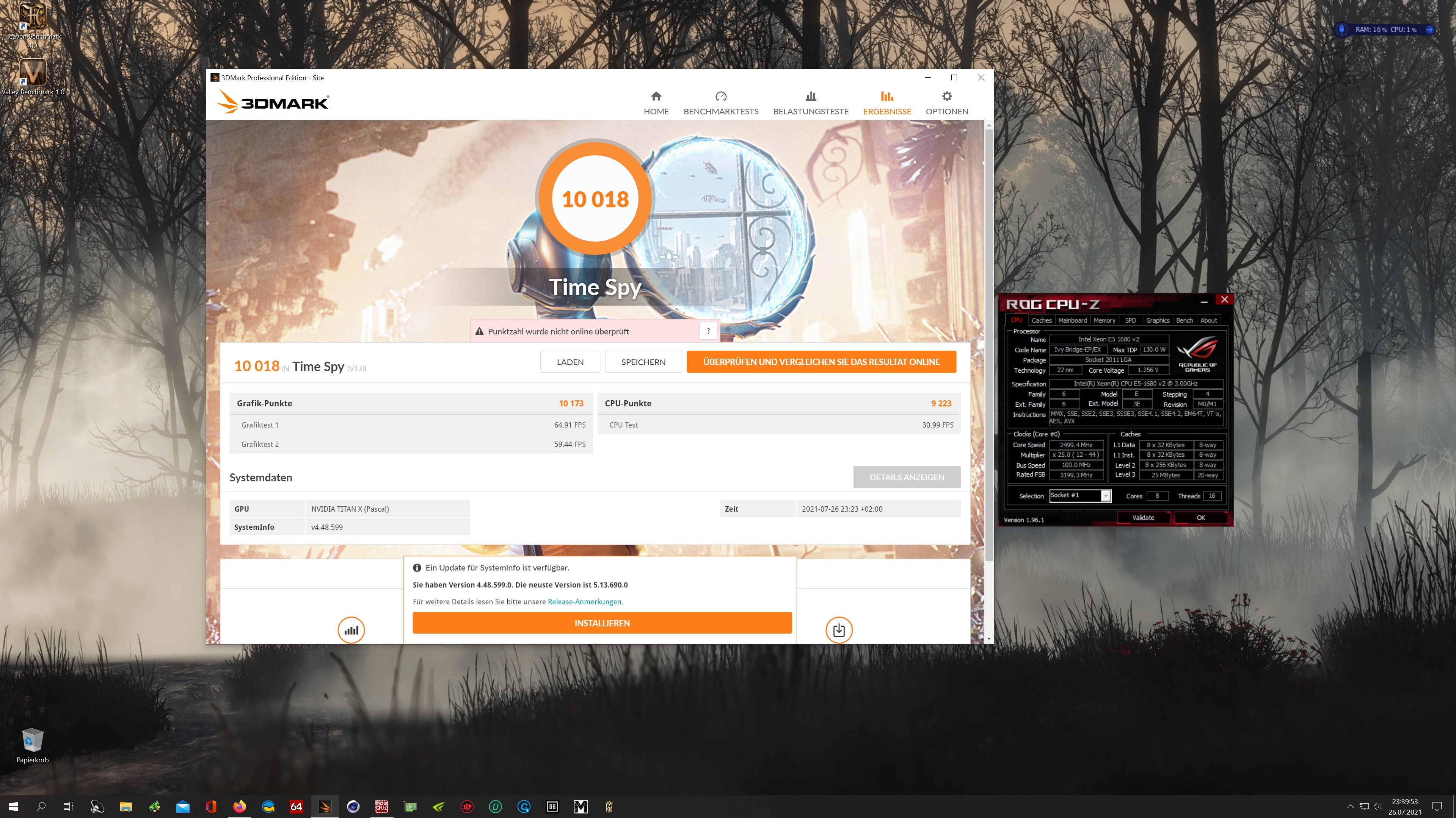

After tweaking and testing I found the sweet spot of my 1680v2. It seems that I was lucky and got a good CPU ... it only needs 1.256 mv for 4,4ghz :)
The max temperature was 51 C while running Aida64 Stresstest for about one hour (thanks to my water loop)
All in all I´m pretty happy with that "old" CPU. In the next days I´ll try to find it´s max stable clock. But 4.4 with 1.256 mv will be my 24/7 setup anyway ...
