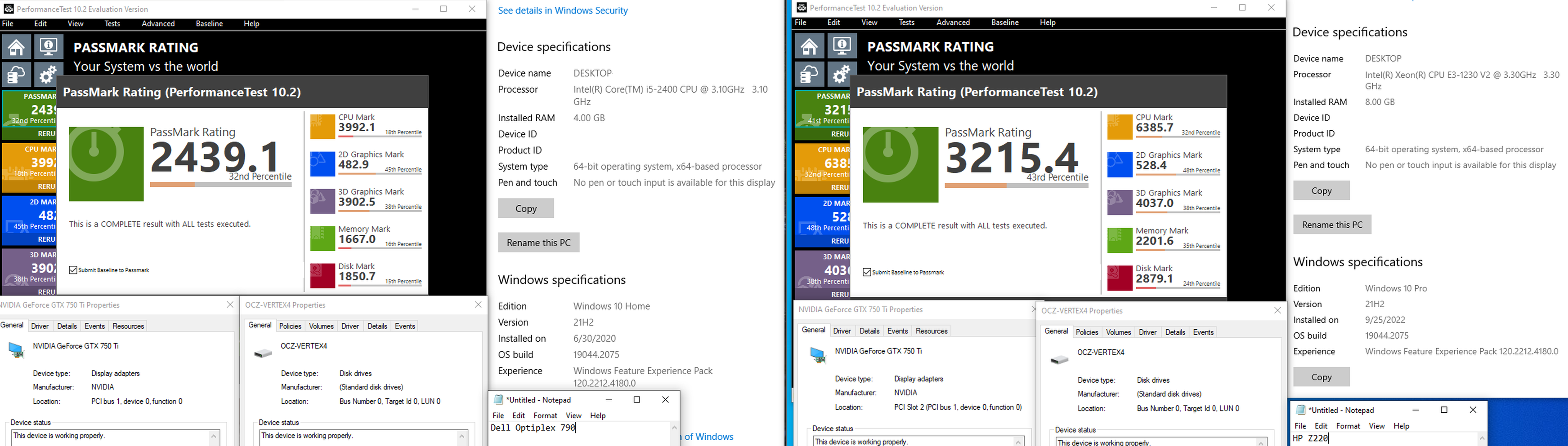

Here's the Dell Optiplex 790 vs HP Z220 rundown:

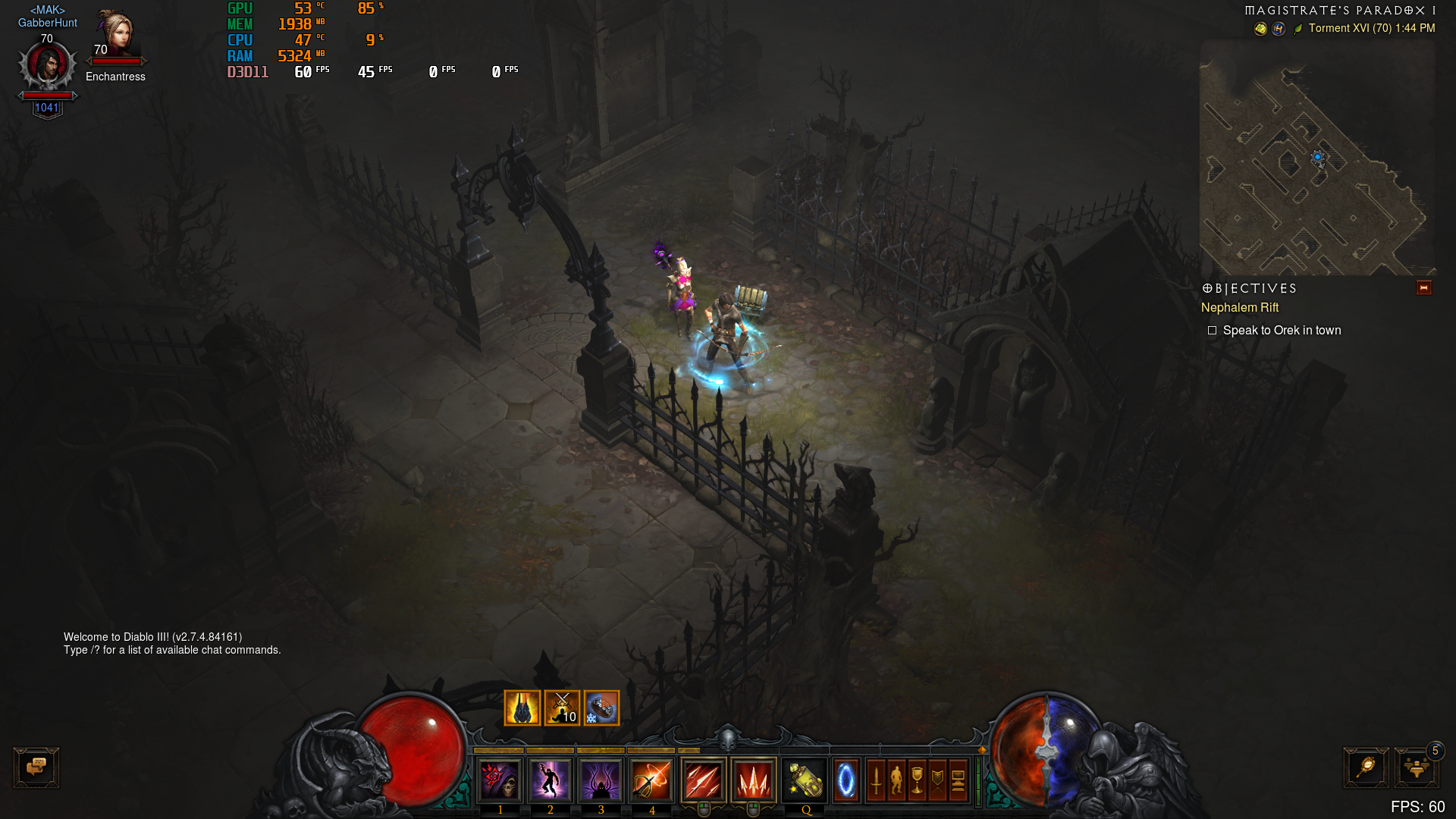

And Diablo 3 running 60fps @ 1080p. Kinda odd to see CPU usage hang around in single digit % usage.
And Diablo 3 running 60fps. Kinda odd to see CPU usage hang around in single digit % usage.
http://lstwo.com/images/86976742554526014961.png
