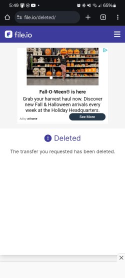

I bought a bios programmer and was ready to flash but then I see the file is no longer available in your file .io link. If you can, please fix it or provide me with the file another way. If you cant I guess ill have to figure all of this out on my own unfortunately (also sorry for bumping an old part of this thread)

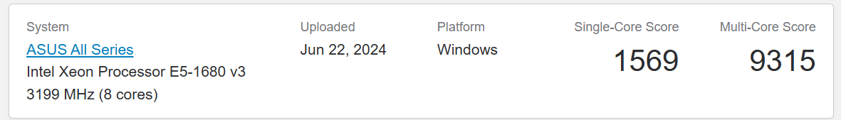

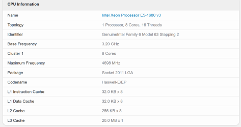

I plan on buying a 1680v3 and overclocking that for a nice improvement to multicore performance (strikes a great balance between a single core and multi core performance uplift for price they're going for right now at 30-40 USD). According to the Geeck bench data I saw on the 1680v3, overclocked users reached a single core score of 1490+ (my 1650v3 only reached 1336 and the 1650v4 was even lower at 1250).
Here's a link to the search results if any of you are interested (I actually saw one hit 1569 in single core which is close if not equal to a stock ryzen 5 3600 THE ultra budget baller gaming CPU)

Thanks, I was successfully able to download the file. I can't wait to try this and see if I can get a performance uplift with rebar enabled on a RX Vega 56 if not that still means ill have the feature available once I get my rx 6600 xt in the future:)
