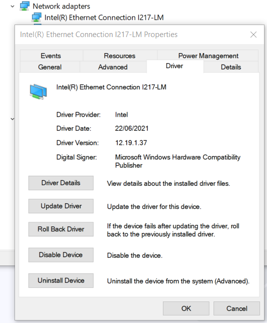

also installed a newer driver, cause in ipconfig it said i had i217-LM ethernet card so i installed a newer driver for it.
still nothing.
thinking of uninstalling the driver and reinstalling it again..
