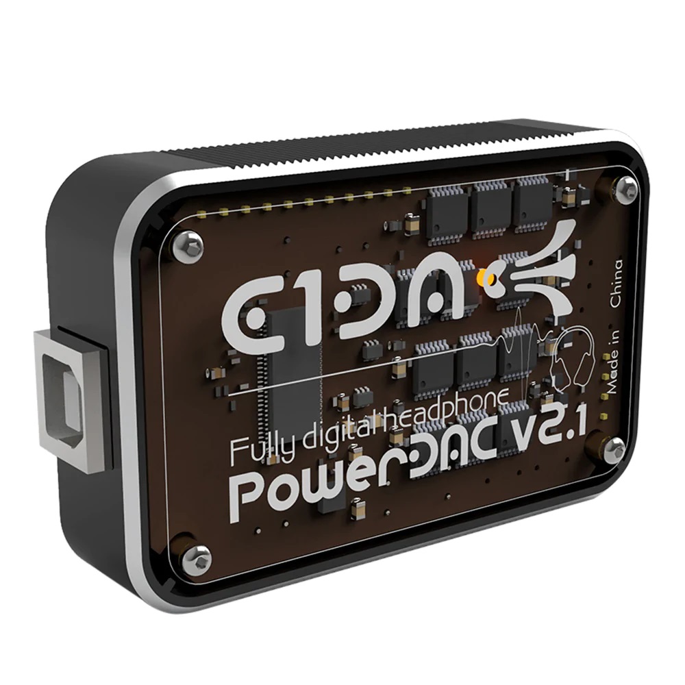

Check this out (if you read the page from Texas Instruments): E1DA PowerDAC V2.1 – Linsoul Audio
View attachment 266492View attachment 266493
Fascinating but I'm suspecting that little box operates at high temp. Could it last ?

Class-D is very efficient compared to power amps (analogue), it uses less power and produces less heat. My older Z5500 had an analogue amp, and got very hot (has radiator).
The Z906 has no such radiator and remains much cooler at high volume, so the answer is, it should be cooler than normal, but we are talking low watts.
