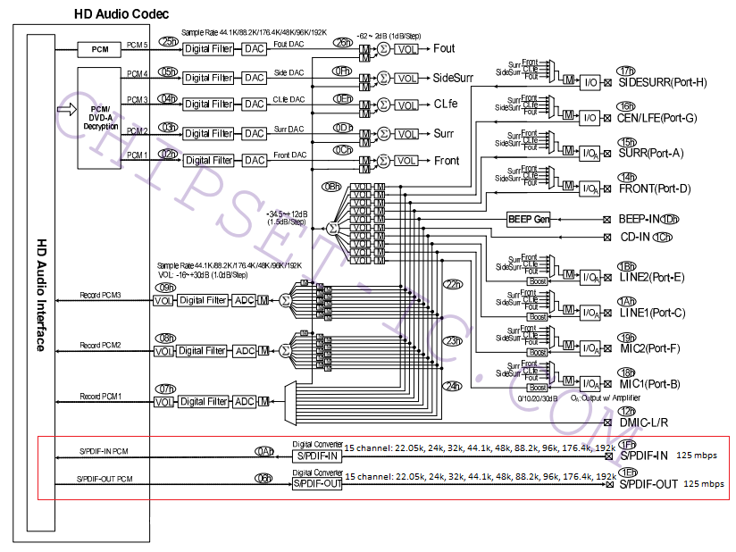

I can tell you APO4 does improve audio quality before encoding to DTS Interactive, and PCM enhancers found on analogue can be added to SPDIF-HDMI, APO's are PCM processors.
For example, does DTS:X and/or Atmos upmix stereo to multichannel or do you have to tell the receiver to do that? I don't see the point of endpoint compression.
The reason DTS Interactive existed was due to bandwidth issues with early TOSLink (3.1 mbps), HDA audio is ~37mbps.
In terms of HDMI, the only reason to compress PCM that otherwise would be output as PCM, is the TDMS issue, as in not enough bandwidth due to high pixels/refresh.
Current standard SPDIF allows for up to 15 channels PCM, so as far as more channels, then again you would need compression, for example 32 channels.
I don't know many consumer standard receivers that do more than 15 channels, certainly not 32.
Windows audio will also need an update, since it only sets up to 8 channel PCM, regardless of your hardware.
This is DTS APO4 (PCM Processor), with 11.1 and 'any' channel support, now try and get Windows to show 11.1 on analogue with 4 plugs, lol.

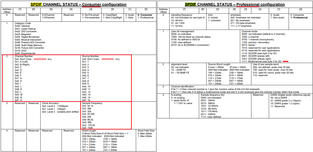

So how do you get true 15 channels with DTS:X if the input to the processor is 8 channels? By true I mean not upmixed from 8 to 15.
Thats SPDIF with added formats converted to form factor HDMI, notice the first image is that of HDMI.
If I had an 11.1 DTS track and then decoded it to PCM, how do I output 11.1, if Windows and the Media player are a max of 8?
If I did passthrough of the DTS 11.1 track, then PCM is skipped and APO's do nothing (which is normal).
I can see DTS have put 11.1 PCM processing into APO4, but there is not a 11.1 analogue system, or support in Windows.
Even though HDMI can do 32 x 48k (so can anything doing ~37mbps, including SPDIF), you can only set the device to 8.
SPDIF however:
Very sad to have hardware we cannot use properly, especially when it already exists.

A few good reasons to use lossless DTS-Dolby over PCM, bandwidth issues (including HDMI, and cable length), more than 8 channels (same as the driver, 6 instead of 2 on SPDIF).
Ultimately Windows and apps, should be changed to essentially support 'any' number of channels, for digital there is not strictly a need for any speaker config.
Even a two channel soundbar could accept 15 channels as input, which means it has dedicated true channel source for spatial over 2 channels.
At the moment we are restricted in programming to 8 channels, regardless of form factor.
Even if I had a new sound card, that has current 15 channel SPDIF consumer standard, and a receiver that is also 15 channels, I can only setup 8 channels via Windows/Apps.
Once people get off their bums and actually upgrade their coding to current standards (including HDMI), DTS-Dolby can do PCM processors.
This also opens up more options with hardware, for example my 'Optical Smart Speaker' design, which works in PCM.
In this design, the DAC (PowerDAC, Class D style) is in each satalite unit, and LFE unit. The input to the main receiver is optical PCM (LPCM), the main unit is mostly a DSP.
By being a DSP, it can decode compressed audio (all formats), amplify/enhance PCM audio (15 channels), then send each channel out in PCM form.
This is much like your sound card, but as an all in one for SPDIF and lossless optical.

I would happily buy a PCI-E SPDIF Home Theatre (HT) device to bypass the legacy standard SPDIF that is built into Realtek (even Realtek can use 15 channel SPDIF transmitters).
So if you enable DTS:X there is a speaker config for 12 channels via Windows sound panel? or does it still only show 8 channels? can you take a screen shot?
If you can see 12 speakers in the Windows config, can you click each one and get sound from that specific channel?
Seems odd that Windows can process 12 channels PCM, but not config the device without DTS:X.
On a side note, with the right app and WASAPI-Exclusive, I can bitstream all formats even with my Realtek, my sample files are also below the 9.2mbps standard (2 x 192k).
15 x 192k is just under 70mbps, and the largest compressed format is 24.5mbps (maybe more with X), you will more likely see 15 x 96k on HDA.
HDA is capped to a maximum of ~37mbps, so 15 x 192k is too much for HDA (Analogue, SPDIF, HDMI), 15 x 96k is 34.5mbps.
Extra side note, even a GPU can have a SPDIF HT, JIS F05 output (standard optical out). Personally preferred over conductive copper, and has a longer range.
Optical TOSLink is rated lossless, I don't believe conductive cables are rated lossless, plus devices are electronically isolated.
If you are using Equalizer APO, make sure you are using the latest version, if you get weird audio after setting it up, shutdown and turn off the PC at the wall for 5 mins.
Not sure what causes it, but it goes away. I also updated the stereo upmixer config:

52-Channel PCI Card with ADAT and SPDIF I/O
Hardware incoming. Wikipedia needs updating.
Current consumer standard SPDIF, 15 channels (plus any mode), 192k, 24bit:
15x 192k PCIe SPDIF Card (consumer) >> TOSLink (one cable).
All formats currently available on HDA (~37mbps).
As mentioned, to use the full 125mbps, we need parallel HDA.
