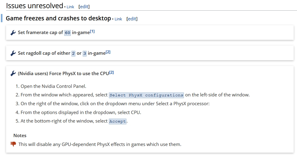

From what I see on PCGamingWiki :
You could try the ragdoll cap maybe.
