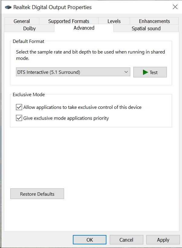

Well, i've made some progress. I'm still yet to test things out, but i've got DTS/DD appearing in both the Windows Digital Output Advanced tab & Realtek HD Audio Manager now!...
On the Advanced Tab, I get a tone through the L-R channels only, but on the Supported Formats tab I get a tone through 5.1 channels with both DTS Audio & Dolby Digital (which I did prior to installing the patch).
My Specs...
Edition Windows 10 Home
Version 20H2
Installed on ‎4/‎09/‎2020
OS build 19042.685
Experience Windows Feature Experience Pack 120.2212.551.0
Motherboard: ASRock Z68 Extreme3 Gen3 (yes old!)
Speakers/Amp: Yamaha TSS-10 http://www.audioreview.com/product/speakers/home-theater-speaker-systems/yamaha/tss10.html
Drivers used were from my Motherboard's website https://www.asrock.com/MB/Intel/Z68 Extreme3 Gen3/index.asp#Download
("Realtek_Audio(v7560).zip")

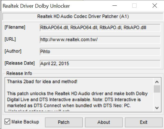

& I used the Patch others here have used. This patch caused the most headaches, as you needed to (a) Allow Windows to access it in Windows Defender & (b) delve into the file properties & allow permission for all users listed. Once that's done, then you can patch the relevant files with this patch file moved into the drivers folder containing the two files that need patching.
I followed the instructions here (which I found after Googled this issue & included my motherboard)...
The solution:
  1. You need to download this patcher (alternative link) that will enable the missing features.
  2. Download a driver that is still compatible with the patcher - in my case I've used version 2.82, the file name is "0009-64bit_Win7_Win8_Win81_Win10_R282.exe" (this is a two year old driver!!! I've tried to use the official one for my motherboard but the patcher didn't work).
  3. Unzip the driver installer .exe file (using WinRAR for example) to access the contained files and patch "RltkAPO.dll" and "RltkAPO64.dll" in the "WIN64" directory (see "[Filename]" section in the patcher user interface).
  4. Install the driver (run "Setup.exe" from the extracted driver) - here you might get a warning from Windows that the driver is not signed!
  5. Reboot and finish configuration in the "Sound" window:
    a) on the tab "Enhancements" check "Disable all sound effects"
    b) on the tab "Advanced" select "Dolby Digital Live (5.1 Surround)" or "DTS Interactive (5.1 Surround)" - FINALLY!!!
Will start testing soon hopefully...
EDIT...Tests completed!
DTS/Dolby Atmos demos & a multi-channel game all worked as expected - the Yamaha AMP switched to whichever default format mode (DTS or Dolby) I selected in the Realtek HD Manager & they accurately had sound coming from surround channels (not mimicking the fronts).
Spotify also forced the AMP to switch to whichever mode I selected, but retained the songs in 2 channel, as it should.
So it's all working now!!! Thanks for the tips here, people. It was a struggle, but we got there....

I did the following Steps:
1 - Uninstalled the Realtek HD Drivers and restarted PC
2 - I downloaded both Realtek R2.80 & R2.82 Zip files as I tried both. (Note R2.80 allowed the Realtek Manager, where as R2.82 did not)
3 - I then extracted the zip file to an install folder on the Desktop
4 - I then downloaded and used the Realtek HD Sound Driver Patcher (A1) from Pihto (22-04-2015) and copied it to the install folder
5 - I applied the patch to both RltkAPO.dll & RltkAPO64.dll in the Win64 folder
6 - I then ran the setup as administrator after successfully patching the files
7 - During the installation, a pop-up from Windows Security requesting to install the unverified driver/publisher, which I selected to install anyway
8 - After installation completed, I restarted the PC
For the R2.80:

Well, i'm back to square one after upgrading my PC with a Gigabyte B550 Aorus Pro AX Motherboard :cry:
It has has the ALC1220-VB codec. Being one of the newest of the lot (I assume), I guess we're waiting for an unlock to its DD/DTS 5.1 support of SPDIF?....
It is so pathetic that they can't get this right in 2021...I can't play my games without proper working surround sound, nor can listen to music etc. when i'm not even sure stereo's being sent properly. :banghead:
Dec 8, 2020
3,156 (1.97/day)
United Kingdom
Oh man dont get me started, I can read and see Toslink is 125mbps which is more than enough to do 8 channel 192khz 32 bit uncompressed (PCM). Weird restrictions and catching up, I think.
You should be able to add DTS interactive and more to the ALC1220, but I think its new enough most modders are not using it yet.
Off the top of my head I see no reason why you cannot add the DTS Encoder to the EFX of digital.
